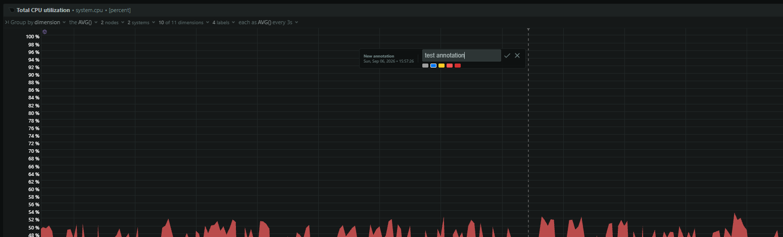

Add an Annotation
- With the default Pan tool selected, click anywhere on a line, area, or stacked chart at the moment you want to annotate. A dashed grey marker appears at that timestamp, together with a New annotation box showing the selected date and time.
- Click the + button in the box to open the annotation form.
- Type your note and pick a priority by clicking one of the color swatches (see below).
- Press Enter or click the check mark to save. Press Escape or click X to discard.
The saved annotation is drawn as a solid vertical line in the priority color, with a small dot at the top of the chart.
Clicking a chart also locks playback at that point in time, as described in Play, Pause, and Reset Controls. If you clicked by accident, use the X in the New annotation box to dismiss the draft.

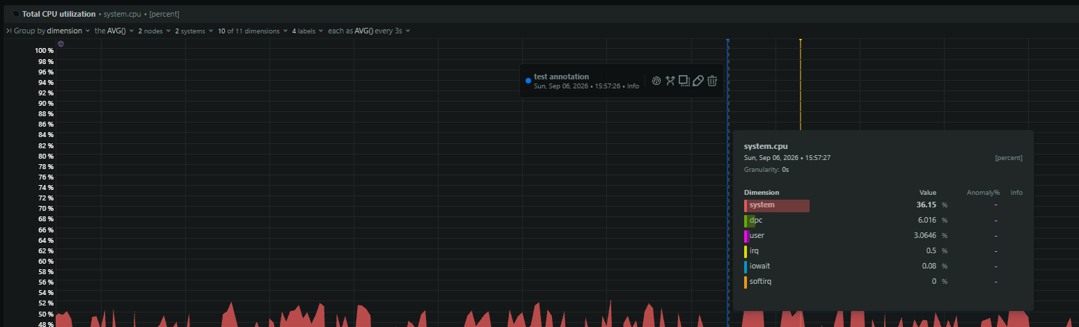

View an Annotation
Hover the mouse close to an annotation's vertical line. A popover shows the note text, the date and time, the priority, and an action bar. The popover stays open for a moment after you move away so you can reach its buttons.
| Action | Icon | What it does |
| Sync / make global | Globe | Click once to show the annotation temporarily on all charts in view. Double-click to make it global. See below. |
| Run metrics correlation | Correlate | Runs Metric Correlations on a five-minute window centered on the annotation. |
| Copy URL | Copy | Copies the current dashboard URL, including the visible time range, so you can share the moment with others. |
| Edit | Pencil | Change the text or priority. Available to Admins. |
| Delete | Trash | Removes the annotation after you confirm. Available to Admins. |
